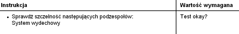

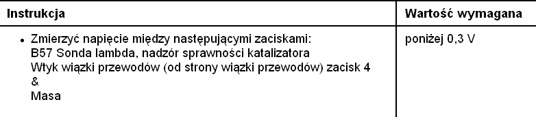

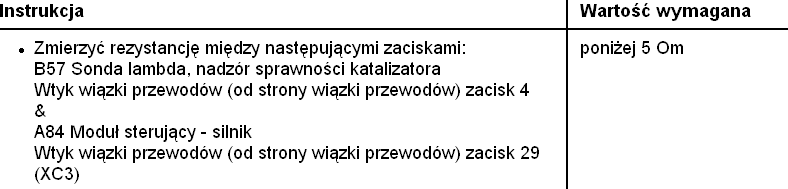

Podam Ci jak sprawdzić.
https://forum.opel24.com/topic/94764-zafira-b-z16xer-powracaj%C4%85cy-b%C5%82%C4%85d-p0420/#findComment-752597
